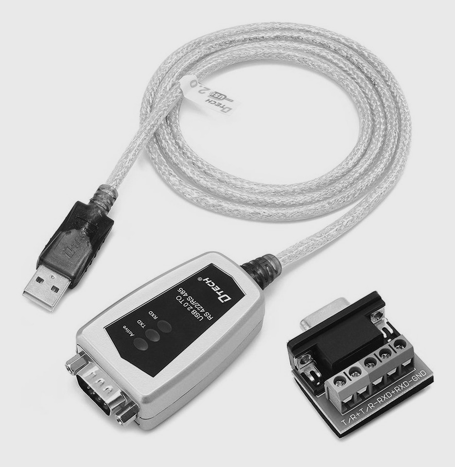

To connect a real NABU PC to modern software, we need a way to replace the original cable network signal. The NABU communicates through its HCCA port, which uses RS-422 differential signaling. This is how the original machine received its data stream from the cable system.
Since modern computers don’t have RS-422 ports, we use a USB-to-RS-422 adapter cable to bridge the two worlds. On one end, it plugs into a regular USB port on your PC. On the other hand, it provides the RS-422 transmit/receive lines required by the NABU’s HCCA interface.
What This Cable Is For:
  • It carries the NABU data stream from your PC to the NABU console.
  • It replaces the original 1980s cable feed.
  • It allows the Internet Adapter software to “talk” to the real hardware.
  • It handles proper voltage and signaling levels for RS-422 communication.
Why RS-422? The NABU PC wasn’t designed for RS-232 or USB. RS-422 was chosen for extended cable length support, noise-resistance (differential signaling), and reliable streaming performance. By using a USB-to-RS422 converter, we simulate the original NABU network link in a modern, safe, and reversible way.
RS422 On Amazon
Video Introduction: If you want a quick visual explanation before building the cable, here’s a video where DJ introduces the USB-to-RS422 connection and explains its role.

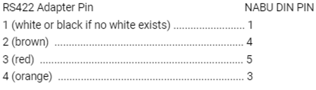

The RS422 portion of the cable must be as short as possible if using a MIDI or serial cable. Or, if using two twisted pairs (preferred), the cable can be much longer. Also, keep the RS-422 cable away from AC power cords. The cable should be shielded only to the GND pin of the DTech RS422 adapter. Lastly, It is recommended to use a twisted-pair Ethernet cable. Connect the RX+ and RX- on the same twisted pair. Do the same with the TX+ and TX- on the same twisted pair. This cable is the lifeline for your NABU, so do not chance a poor-quality effort.
Some people choose to use a MIDI cable, but it won’t be a twisted pair and therefore isn’t RS-422-compliant. If you are hard-set on using a MIDI cable because the 5-pin DIN connector matches the NABU, keep it short. And you won’t get much love if you complain to users that the NABU keeps disconnecting *wink*. If you need a longer cable, consider extending the USB portion rather than the RS422 portion (unless it is a twisted pair).
Note: GND should be connected to the shield only at one end. If your cable is grounded on the DTECH connector, do not connect the shield to the outer rim of the DIN connector. Why?
5 Pin DIN Pinout
This is the pinout of a 5-DIN connector from the solder side.
RS422 Breakout
If connecting directly to the DTech RS422 adapter breakout, use this image as a reference.
RS422 DB9 Cable
If you have a DB9 cable with wire codes. Well, I’d verify the wires first, including their colors, to make it easier.

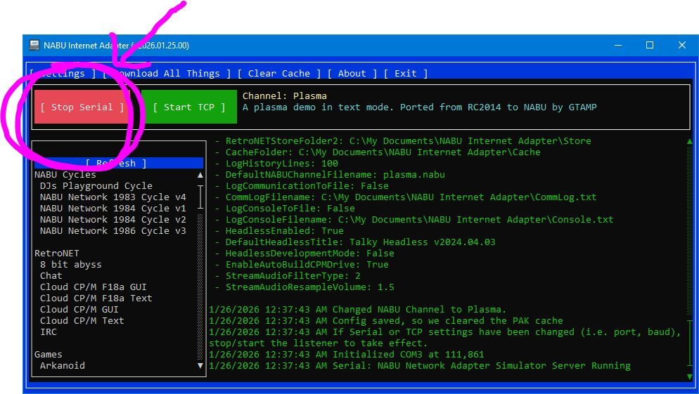

  1. Launch the Internet Adapter by double-clicking the shortcut in the Start menu if on Windows. Otherwise, execute the binary on your preferred operating system.
  2. Press the SETTINGS button to open the settings menu and configure the COM port.
  3. Select the RS422 USB port from the list in the Serial Tab and press SAVE. The Settings window will now close.
  4. On the main window, press the START SERIAL button.
That’s it! The NABU Internet Adapter is now sitting, waiting, wishing for a NABU PC connection.

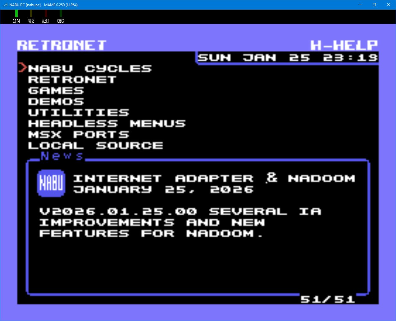

Once NABU connects to the Internet Adapter and finishes booting, you’ll land in the RetroNET Headless menu. This menu was designed to feel like a cable-style channel navigator — reflecting how the real NABU PC was initially used in the 1980s. Instead of loading software from disks, users “tuned into” programs broadcast over the cable network.
What RetroNET Headless Is: a launcher interface for modern NABU software. From here, you can browse and launch programs (often called “channels”) that run on the NABU PC.
What You Can Do From the RetroNET Menu:
  • Run the original NABU Cycle software. Experience the same programs that real NABU users accessed decades ago.
  • Read the latest NABU news feed. The community maintains a modern online news stream for active users.
  • Play modern homebrew games. Developers are still creating new titles for the NABU, including action, puzzle, and retro-inspired projects.
  • Load CP/M. CP/M opens up a full suite of classic computing tools, text editors, compilers, and utilities.
